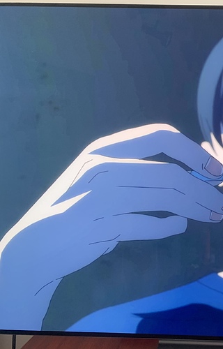

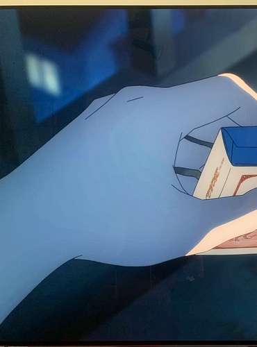

Severe banding playing anime files in Infuse Pro ATV 4k. Attaching a few screens comparing how Infuse displays the video stream vs the native tv media player. Will attach the the media info in a subsequent reply or a post exit.

Judging by the mediainfo file, this video has a very low video bitrate. And this indicates a large compression of the file. This leads to image artifacts.
You missed the part where I explain I am comparing the same file with the internal native media player of the tv. If the problem was with the file it would also manifest there. VLC on tv os also handles the file better than Infuse.

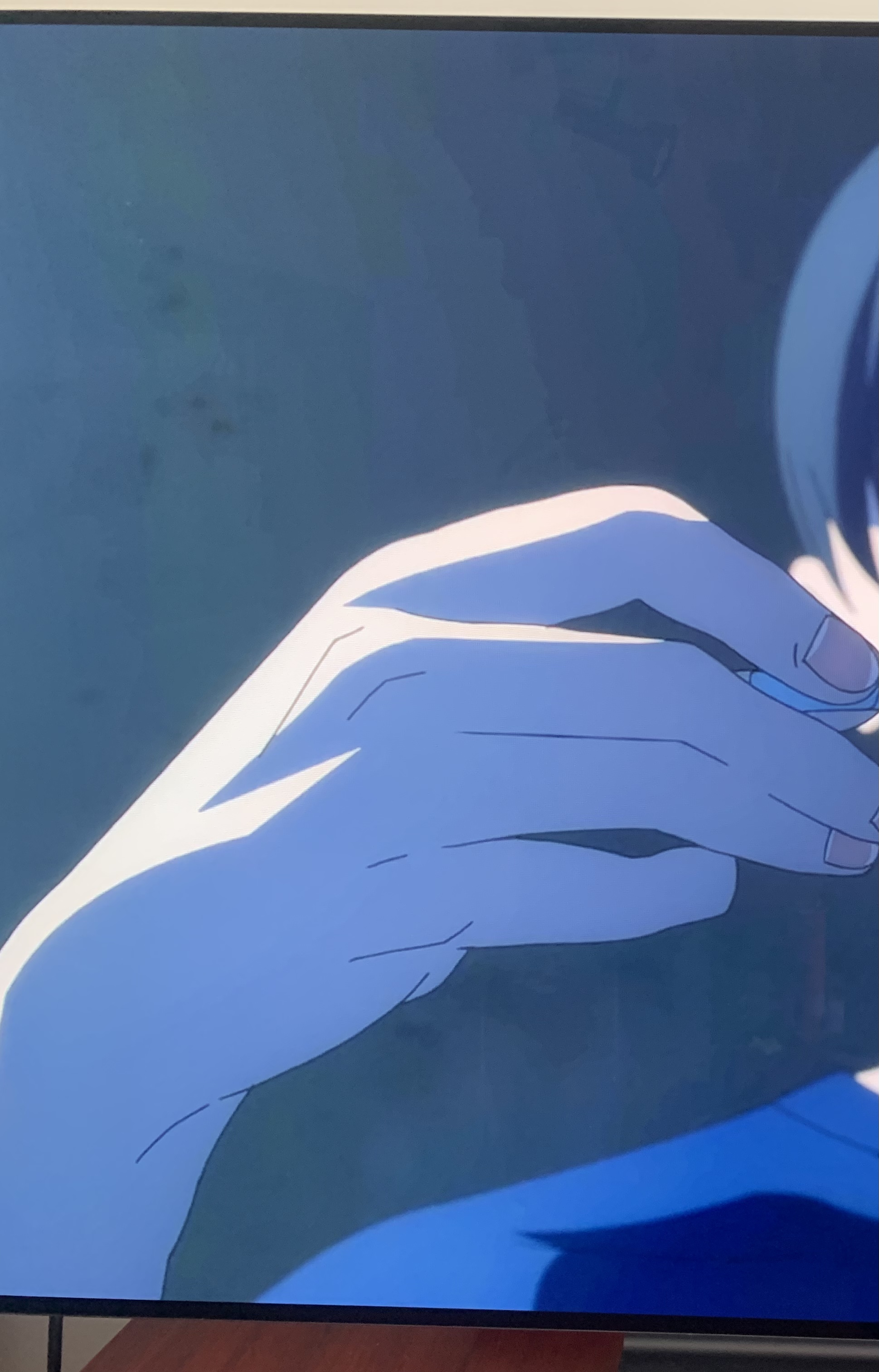

I’ve encountered this again today. I’m tempted to try the Martian next, but really any content with soft gradients exhibits banding / blocking artifacts.

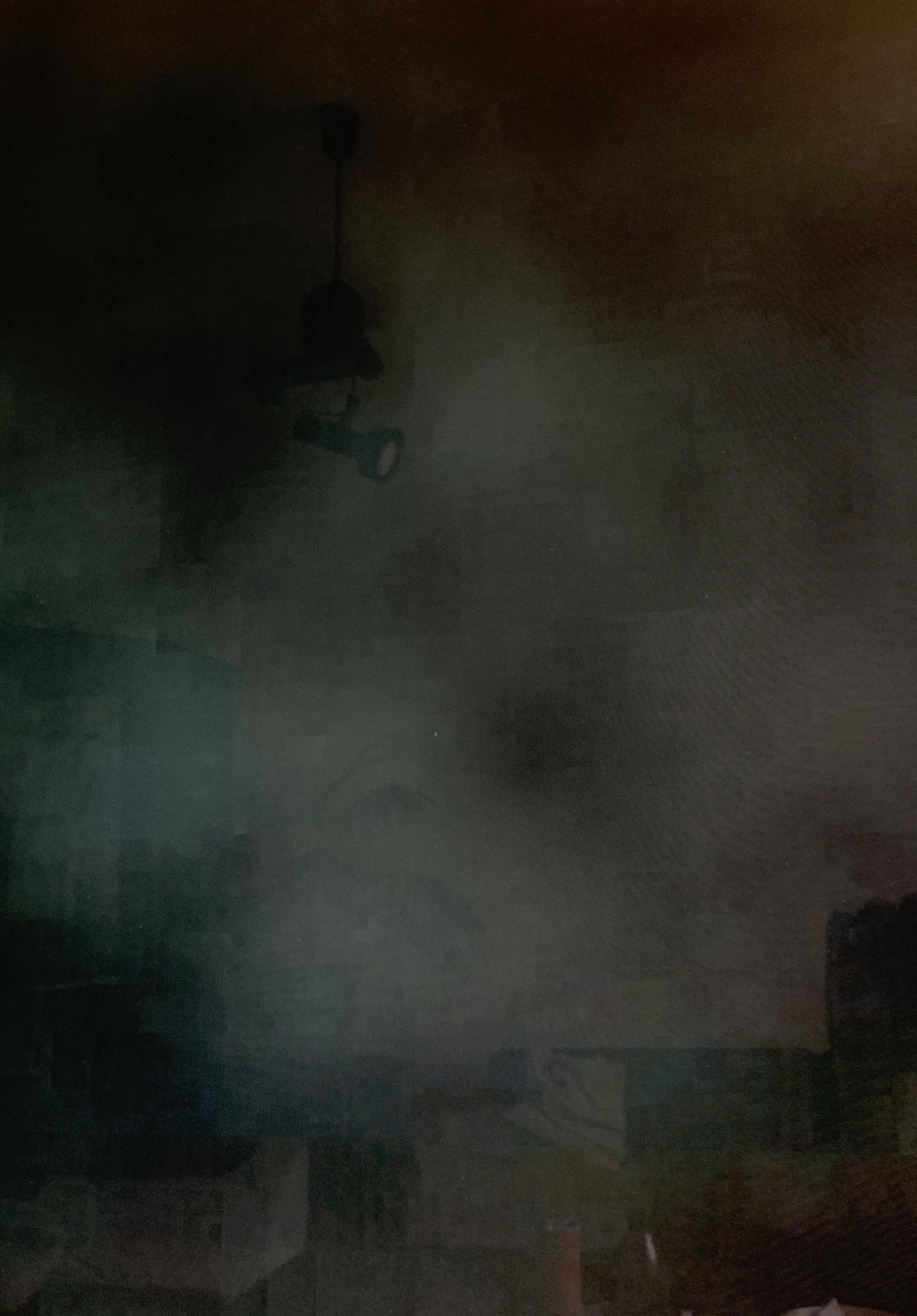

And another example here:
You can see that for example the x265 is much smaller and much better quality on pc, yet on Infuse on apple TV the x264 version looks actually better. So right now I think this is at least an issue with either the way Infuse or Apple TV decodes the media.
For the way Infuse decodes this frame for the x265 stream please look at the first post.
