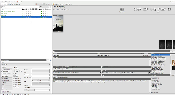

I found a program called Ember Media Manager that creates NFO files and gets metadata from IMDB or TMDB and Infuse will use the data. Did a test with like 10 movies that were matching one word from the title and it fixed them perfectly.
Infuse has limited support for .nfo files … meaning you can display local metadata for a limited subset of tags “on top of” Infuse’s functional (TMDB derived) metadata database — but local .nfo files have ZERO input on how Infuse actually identifies files internally. Infuse identifies your files exclusively through filename (title & release date) matching with TMDB.
If Infuse is unable to make a match based solely on filename, your local .nfo will not be of assistance because the item will never be included in the library and its associated local .nfo contained data will never be displayed.
You’re correct, I just realized that after clicking on a film and the banner was wrong. I ended up creating a folder for titles that won’t match based on filenames that include title and year and set it to use local metadata (retrieved via Ember). That way in the future if I have to rebuild my library for some reason those exceptions will bypass the matching process. Thanks for pointing that out, I won’t bother matching all ~4000 films through Ember now.
