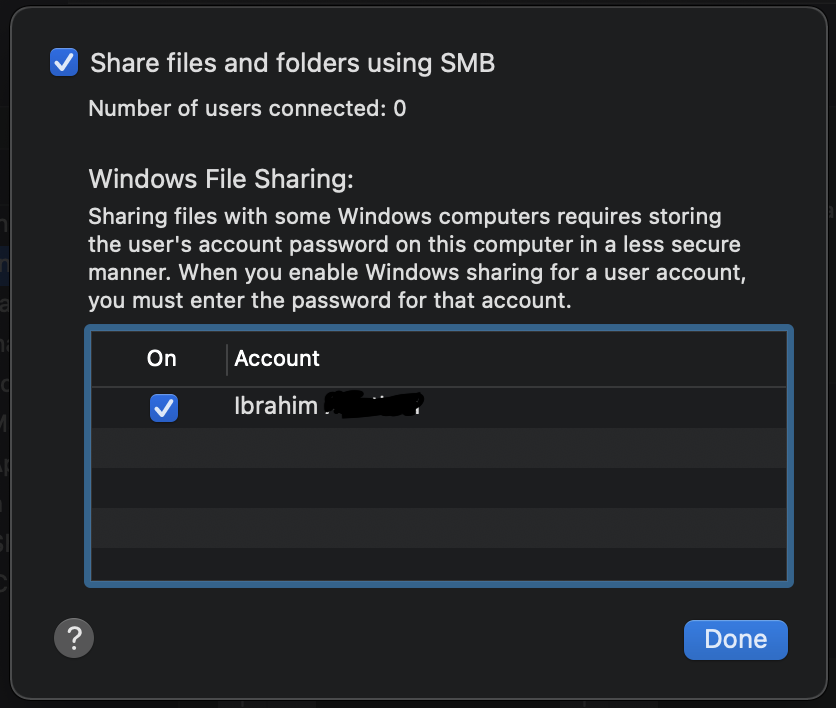

There are a few things to check.
  1. SMB is enabled on your Mac (more info here Set up file sharing on Mac - Apple Support)
  2. At least one user is selected under ‘Windows File Sharing’ (as shown under ‘Advanced Options’ in the link above)
  3. The folders/drives you wish to share are added to the list of Shared Folders
  4. Selected username and password are being entered in Infuse
Note: iCloud username/password cannot be used. If you’re using an iCloud ID to log in to your Mac, you will need to set up a new ‘Sharing Only’ user as described here: Set up users, guests, and groups on Mac - Apple Support
Also, if you’ve recently installed an update for macOS, you may need to disable and then re-enable File Sharing to get it working again.
hi james
as you see in the images sharing on mac is ok
i did disabled the sharing after the update and re enabled it but still the same error message on ATV
