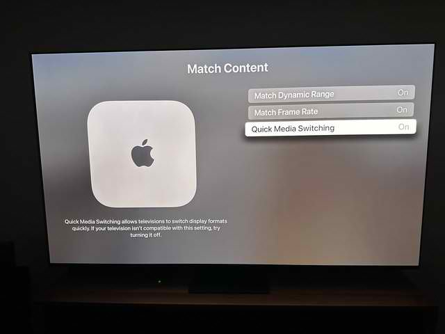

On AppleTV 2022 simply activate it under “Video and Audio” > “Match Content”:

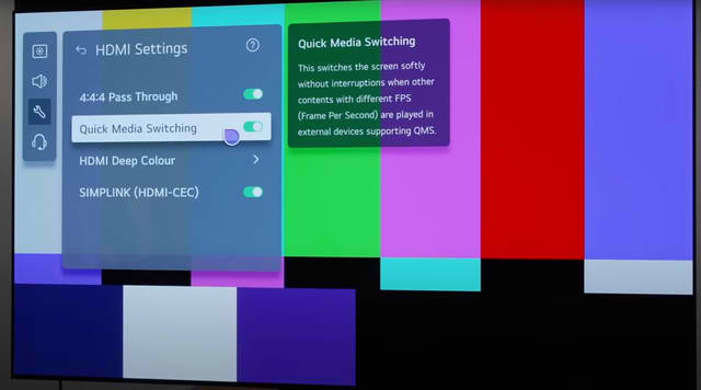

On the LG simply activate it under "HDMI Settings“:
