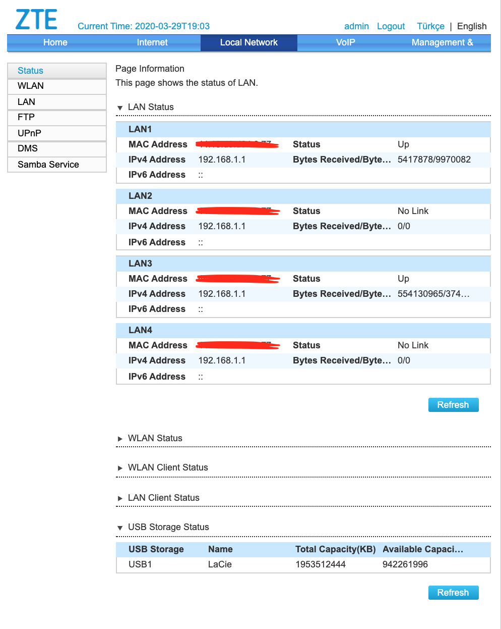

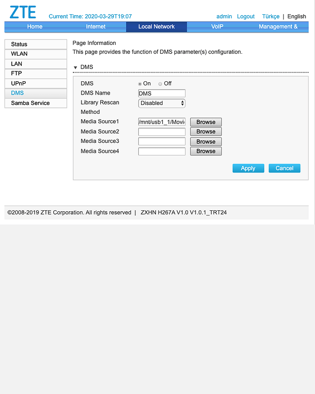

My router is ZTE H267 there is no so much information about it on the internet. Attached you can see a screenshot of supported services belong to router homepage.
As you can see SMB is also seems available but I could never establish a connection with SMB beacuse of the SMB version of my router. I tried all options in Infuse while trying to connect (SMB v1, v2, v3, auto, legacy) I even could not connect to my router via my macbook over smb. MacOS says that SMB version is incompatible.

Sorry for the missing attachments. I attached a few screenshots for your information.
I checked the link you shared about QoS but my router does not have that section available. I couldn’t find a place for user credentials for USB either.
