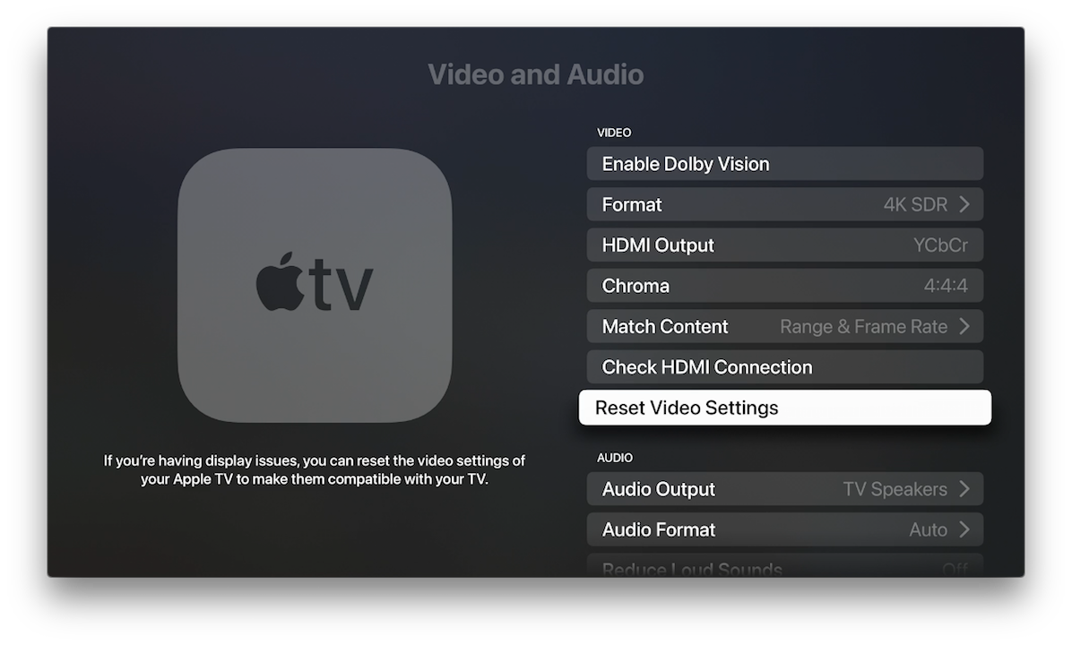

I’ve been having this problem too on my original Apple TV 4K. I seem to have resolved the problem by resetting video settings and then setting up the resolution, refresh rate and chroma again. I am outputting at 4K SDR 60Hz, 4:4:4 chroma, matching frame rate and dynamic range. I have certified Premium HDMI cables (checked by scanning the hologram QR code with the app), but still had the issue.

Just to verify, you are no longer having this issue since you reset the video settings and going through the set up again on the ATV?
No more silent until rewind correct?
Correct, have tested a few video files so far that have worked first time.

I had my Apple 4K tv set to output High RGB for a long time with the sound working just fine.
I have now tried to set my output YCbCr with chroma 4:4:4 and everything works great again.
I have no idea as of why.
After reading here I then tried to reset the videosettings, and now The sound works again also with High RGB.
So fix that worked for me was to reset videosettings on my Apple tv.

For anyone else seeing this issue, can you try resetting video settings in Apple TV > Settings > Video and Audio and then making your preferred selections again to see if this has any impact?
Worked here
Reset your video settings on your Apple tv under settings, and set up you perfered resolution and format. It worked for me.

@james, I was going to reply to @ludacrus to confirm that in my settings resetting video settings and restoring back to the original preferred settings (which are Chroma 4:2:2 and high HDR 4K 60Hz in my case), seems to have resolved the issue with the audio silencing :star_struck:
Resetting the video settings also worked for me. Chroma 4:4:4 with sound is working again
I just changed to RGB high and audio worked. Changed back to YCbCr and the audio stopped. Had to use the ff rew to get it going again.

Did you try doing the “Reset Video Settings” on the ATV then returning the settings to what you want?
Just tried that and put all the settings back to where they were. Bingo. Got sound again.

It looks like this may be a case of some of the Apple TV’s hidden audio/video settings not migrating correctly when upgrading to tvOS 14.7. This would help explain why we were never able to replicate this issue here.
Big thanks to @ludacrus for the sleuthing!
