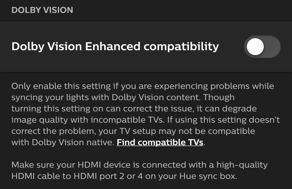

But I find a solution to work sounds again with Infuse (last beta version up to date) : I have a Hue Sync Box between AppleTV and my LG TV. Solution : desactivate Dolby Vision Enhanced option (see attachment)
My system works like this :
NAS with Plex/Jellyfin servers>>>AppleTV>>>Hue Sync Box>>>LG TV>>>Sonos soundbar
I don’t know if this explanation can help you @james to find a path to the right solution, but I prefer to share it.
Luc
