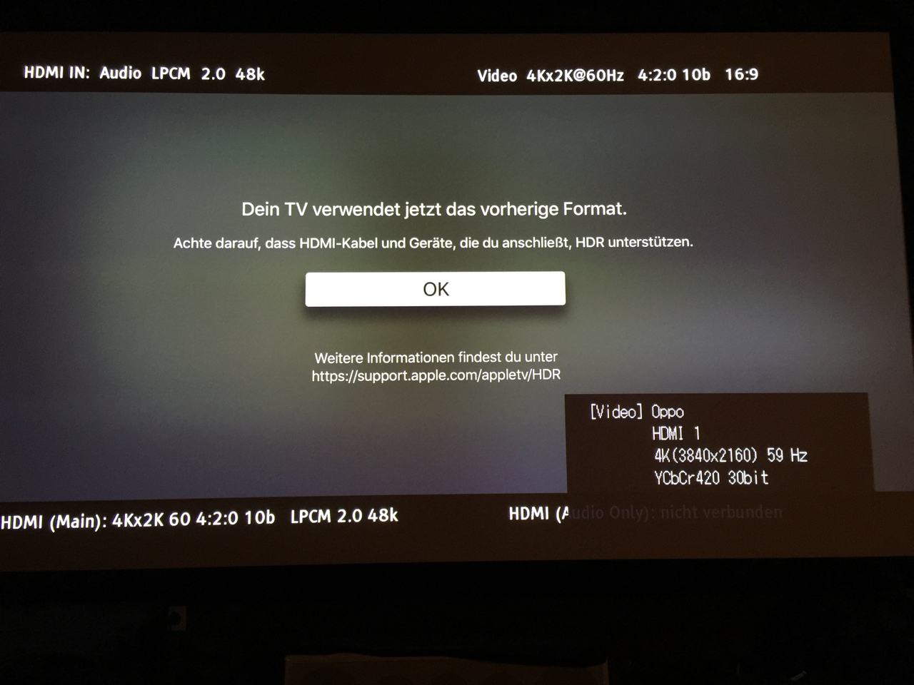

I did some testing and I found the following:
I used the HDMI-IN of my Oppo 203 to get more info on what signal the ATV puts put. In the attached picture (1) you see the result when the ATV is set to 4:2:0. On the top you see the Oppo info on the input signal, on the bottom the info on the oppo output signal. In the overlay on the right side you see how the LX901 interprets the signal. Bottom line, the ATV puts out 4:2:0 with 10bit and the Pio interprets this correctly.

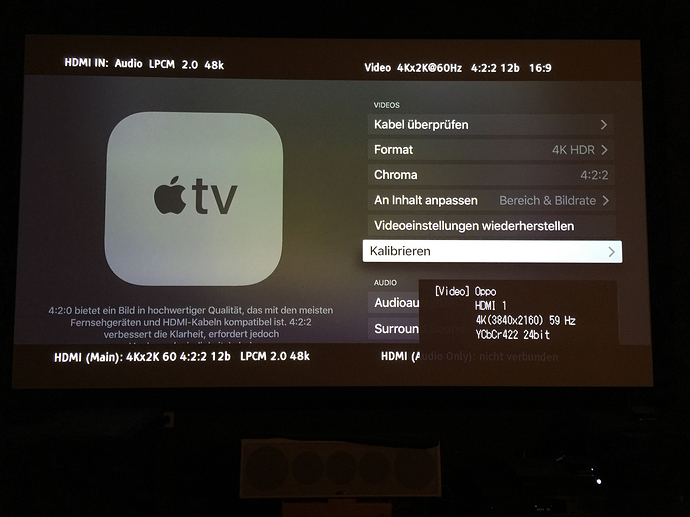

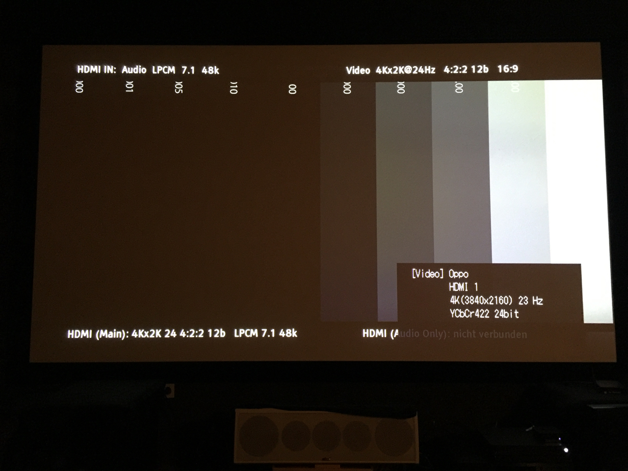

In picture (2) and (3) you see the ATV switched to 4:2:2, picture (2) is a menu screenshot and (3) shows the situation while playing an HDR10 file. The Oppo recognizes 4:2:2 and 12bit on the input and puts out the same format. However, the Pio shows 4:2:2 8bit (3x8bit=24bit).
