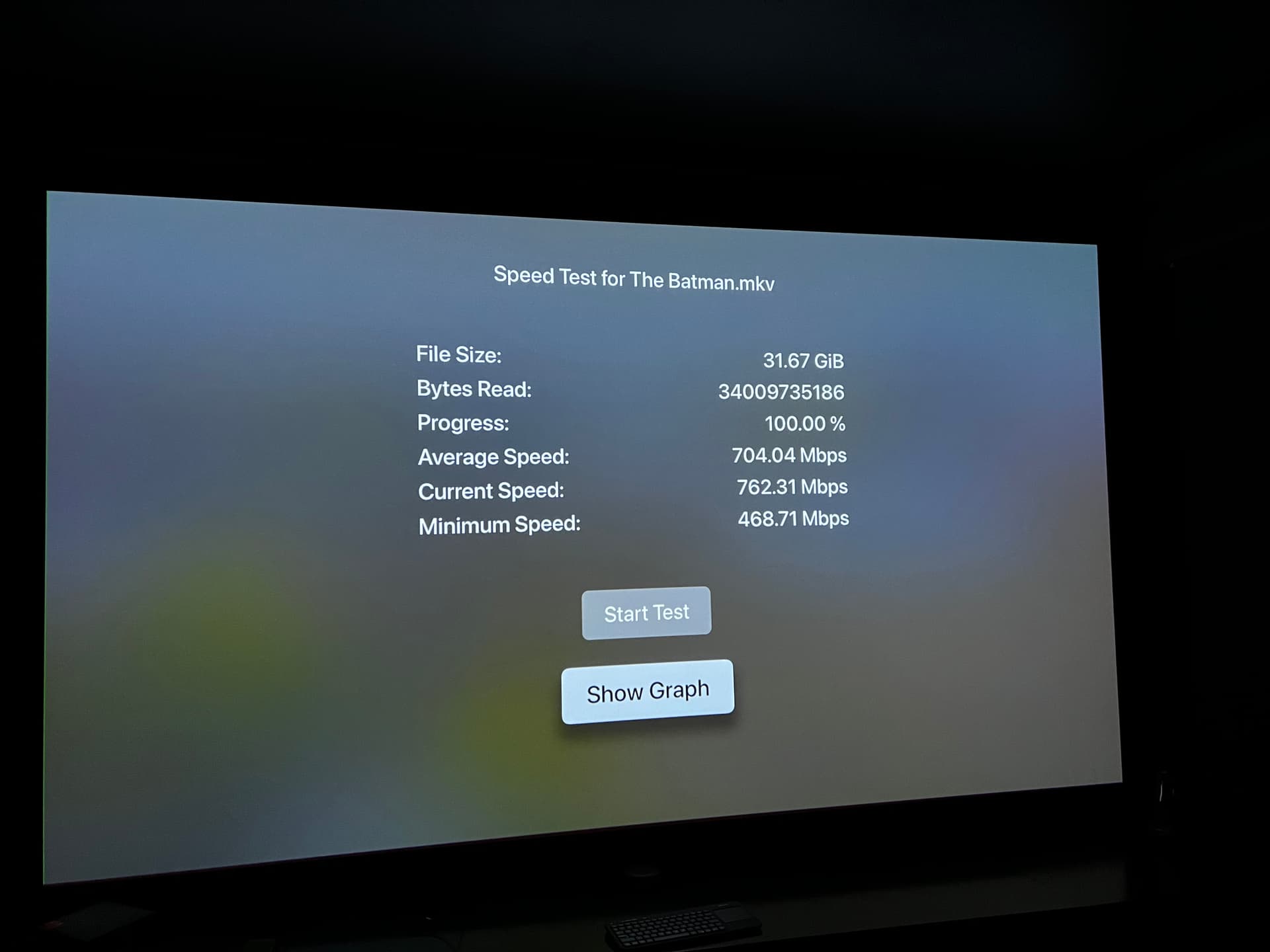

Just to confirm this is infuse Speedtest? And can you test on both SDR and HDR files?
Yes this is a Speedtest through the infuse app and both HDR and SDR files have about the same speeds give or take 20-30Mbps

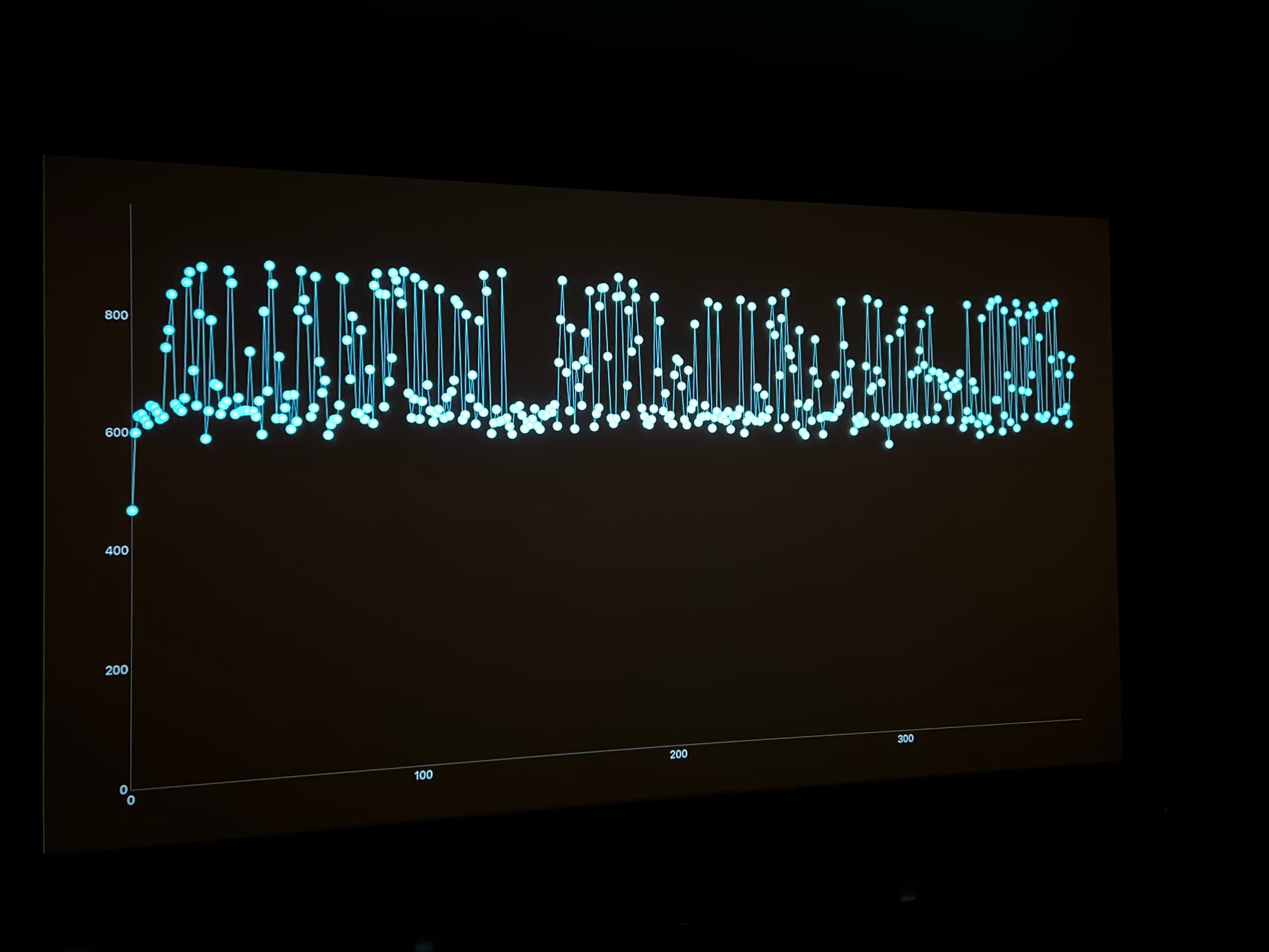

Could you run the speed test on the hdr version and let it run for at least half the movie? It should be pretty fast since it’s not real time, then click over to the graph and post a screen cap of that. Looking for a dip to match the stalls.
Will do, will post results in about 1.5 hours.
Here are the results
