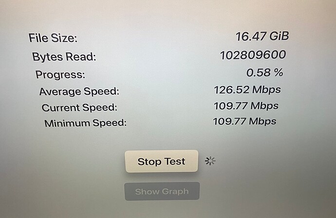

I have run the speed test and the speeds look decent, although they sometimes seem to drop quite low (25) before picking back up again (109).

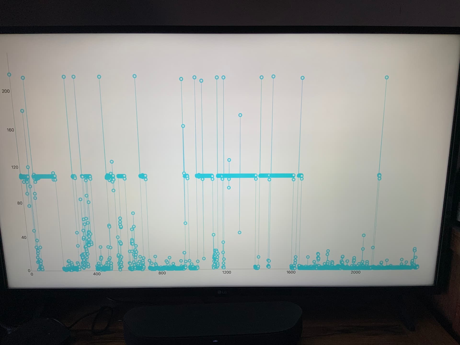

If you let the Infuse speed test run longer ( say at least 50% to 75% preferably 100%) and then go to graph, could you post a screen cap of the graph?

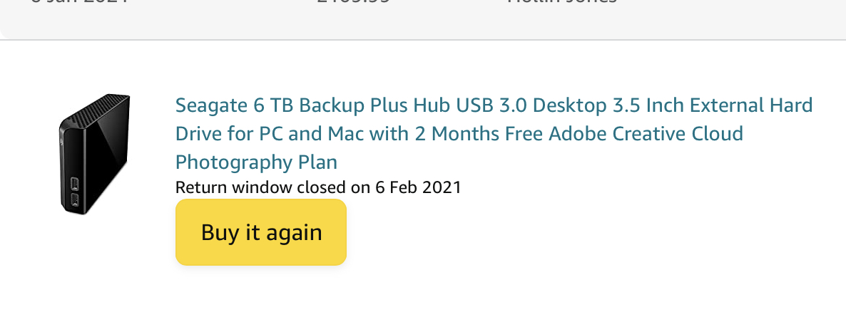

What’s the hard drive model?

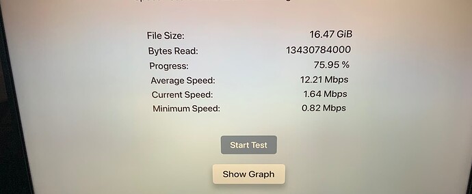

So what I’m seeing is really odd. With a 17gb 4K file, the transfer speeds were all over the place. The test actually cropped out with an error at 75%.
With smaller movie files of around 2gb I’m seeing very fast speeds of 200mbs up to around the first 500mb-1gb in transfer then a massive drop off to around 2mbs.
It very occasionally bursts up again for a few seconds but then it’s mostly back down to extremely slow.
With very small tv shows, around 250mb, I see very fast 200mbps speeds all the way to 100% loaded in a very short time.
Seagate 6TB. It’s fine with read and write speeds when copying to and from my Mac over the network.

Just tried again with a 40GB file, very fast up until the first 200mb of transfer then dives to being extremely slow and mostly stays there.

Btw I just tried deleting and re adding the smb share from inside Infuse on Apple TV. Then I went in and changed the SMB version from 3 to 2 and it seems to have made a massive difference - now when I run the test it blasts up to around 1-1.5GB of transfer before slowing down. I’ll have to do more tests but as long as it does that, and caches properly, that might be ok.
