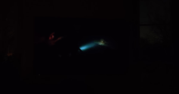

I was watching the Hunger Games trilogy (bluray rip) and a few times I was surprised at how it was mastered, with blacks seeming a bit too gray, but otherwise looking great. Basically scenes which I would expect to be near-black was much brighter than the black bars. Finally, when watching the tunnel scenes in Mockingjay Part 2 I figured something was wrong and compared with the regular HD streaming version on HBO Max. The same scenes had much blacker darks in the standard HD version.
I tried to take some photos at fixed ISO for comparison:
( no rewards for guessing which is one with raised blacks ).
I am seeing the same behavior in both Plex and Infuse (playing from plex, which is set to direct play).
Any ideas?

Some movies are mastered in such a way that blacks are not pure blacks. I don’t really know why they would do that and it is quite annoying, especially on OLED. Anyways I don’t have the hunger games in 4K but my guess is that the streaming version darkened shadows from original. In your picture you can see that shadow detail is definitely lost in the darker version.

It makes sense that standard HD would lose shadow detail vs HDR10, but my TV is capable of displaying shadow detail at darker levels than what is on display here. Also remember that its a smartphone photo :slight_smile: I mean, its quite glaring with the naked eye compared to the black bars. I even noticed the lack of contrast in some forest scenes earlier on ( quite bright scene, but with some shadows ).
