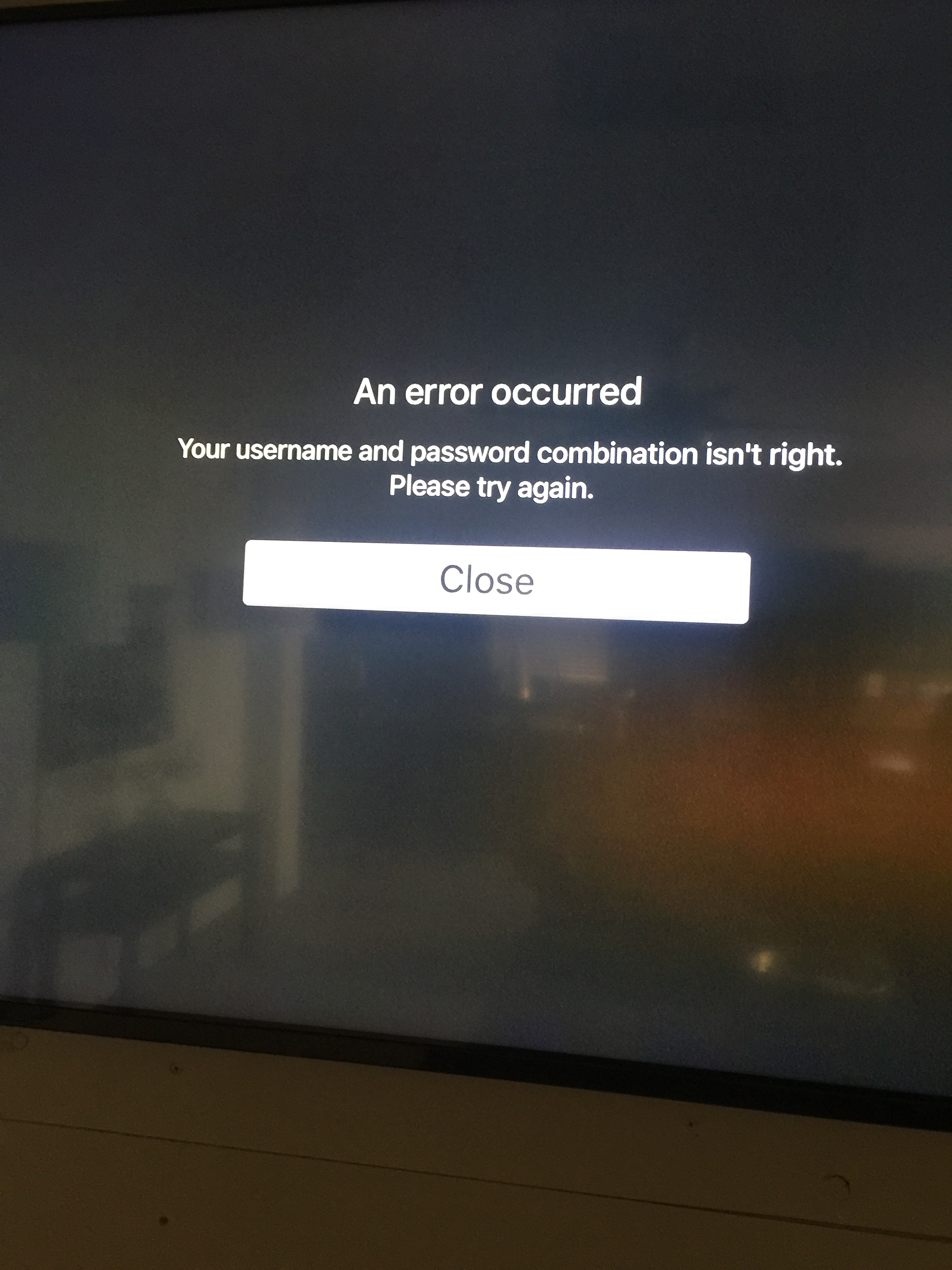

I cant for the life of me connect Infuse to my library after updating to Mac OS Sierra using the same exact settings as when I was using El Capitan.
I keep getting a dialogue that pops up within Infuse telling me either the user name or password is incorrect (and I know without a shadow of a doubt what this is).

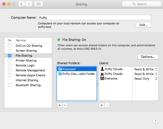

One thing to check, in system preferences>sharing make sure that file sharing is checked and when you highlight file sharing click on the options button and there make sure you have “Share files and folders using SMB” checked and below that it will list have the user listed and checked to enable windows file sharing.
That caught me a few times until I did this.

I’ve tried everything from removing the app from ATV and downloading a fresh copy, restart the ATV and even changing the user password (since the message repeats stating failed login or password).
Oddly, I have an external running my old OS (El Capitan) and it connects perfectly.
I just cant connect to my internal HDD running Sierra =/

UPDATE: Issue resolved it appears. I had select the “On” option for my user under the Sharing->File Sharing->Options->Windows File Sharing settings.
I don’t recall doing this before, but it appears to have fixed my credential issues.

I can confirm finding success after selecting the Windows File Sharing option under advanced file sharing settings.
As a failsafe precaution I also “got info” on the HDD that was storing my files and chose “share folder” option.
