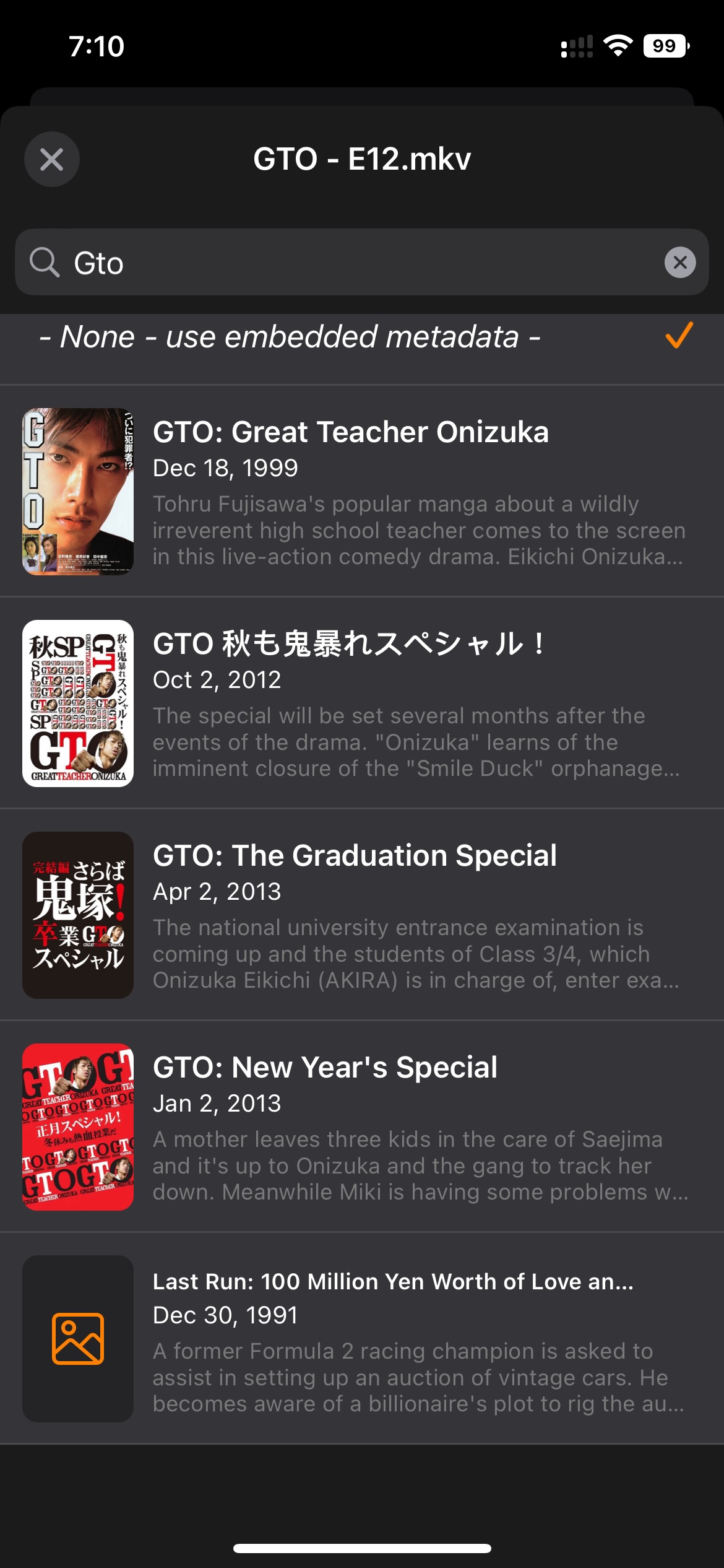

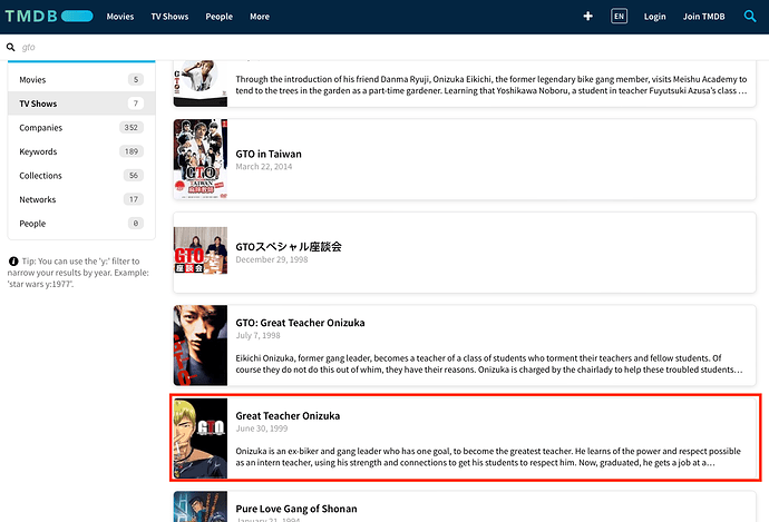

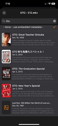

I have an example here. A relatively older Japanese animation series “GTO”. I can find it in TMDB website.
But when I use Infuse to search the same keyword “GTO”, this animation series is not available.

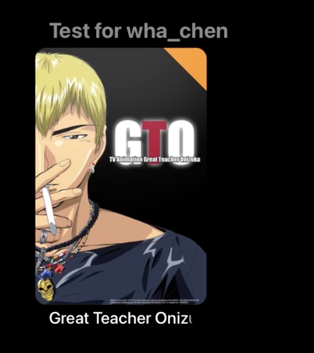

Try naming your files “Great Teacher Onizuka S01E01.mkv”
Worked like a charm.
The reason you couldn’t find it in the search is without the SxxExx in the file name Infuse would interpret this name as a movie and would not search TV shows.
While there are other options the file name format and folder structure above work the best for me.
