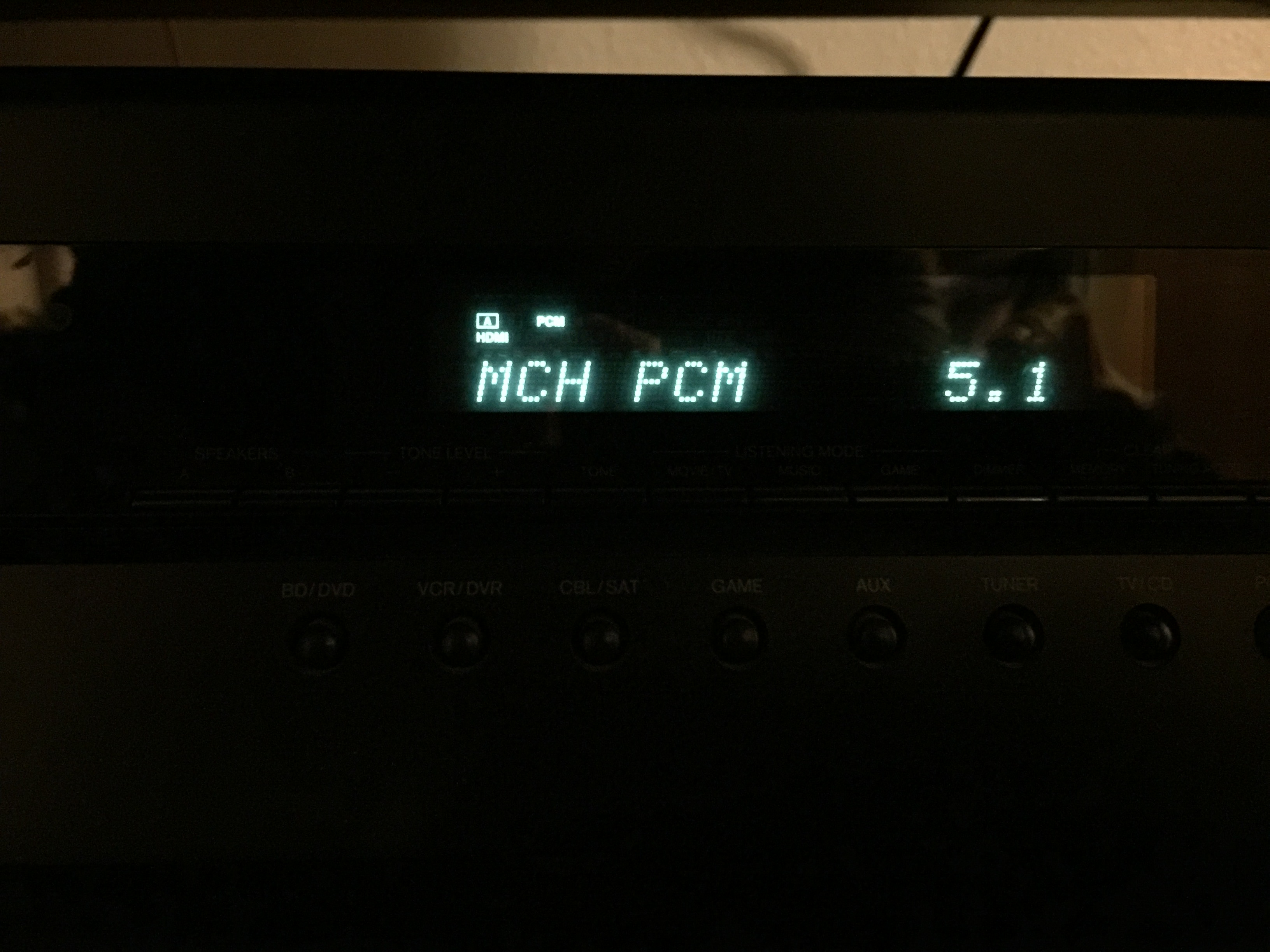

All audio is output as Multichannel 5.1
First I want to state my settings.
Infuse Audio Output: Auto
Apple TV 4k Surround Sound: Best Quality Available
Reduce Loud Sounds: Off
I also purchased Infuse Pro.
I had a quick question. My receiver is an Onkyo HT-R380 it supports up to multichannel LPCM (up to 7.1 ch). http://www.intl.onkyo.com/downloads/manuals/pdf/ht-s3305_manual_e.pdf
When I play a movie with Dolby Digital 2.0 the receiver input audio is Multichannel PCM 5.1.
When I play a movie with DTS-HD MA 7.1 the receiver input audio is Multichannel PCM 5.1.
When I play a movie with DTS 5.1 the receiver input audio is Multichannel PCM 5.1.
I would expect that depending on the movies audio that the receiver input audio would change. Is this not the case?

Thanks for the reply timstephens24. So I used Finding Dory to test. I tried every single audio option and regardless it always showed up as Multichannel PCM 5.1

So the audio that is detect on the input is Multichannel PCM 5.1, but I tried multiple listening modes including direct and it did not affect the detected input audio.

Seems like a legitimate question. It is plugged in directly into my receiver. Also I wanted to add that the audio does change when using other apps. For example when I was using AirPlay to listen to music it was coming in as PCM (not Multichannel)

Yes it does affect it.
If I select DTS 5.1 as the audio track and set Apple TV to Dolby Digital then my receiver reports Dolby Digital 5.1
If I select DTS 5.1 as the audio track and set Apple TV to Stereo then my receiver reports PCM (not Multichannel)

Hey James thanks for the reply so I did some testing.
First the one most relevant to your post. Like I mentioned in my original post:
but when using Netflix
When I play a stereo video receiver input audio is PCM
When I play a 5.1 video the receiver input audio is Multichannel PCM 5.1.
