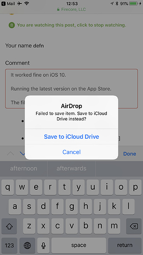

When I airdrop mkv files from my Mac, Infuse doesn’t appear as one of the apps that can open it. :slight_smile:

The files play perfectly fine, it’s just after a successful airdrop, infuse doesn’t show up as an app that can receive it. See attached.

From what we can tell at this point this appears to be a bug in iOS 11.
For a bit of background, there is an common approach for adding files via AirDrop and “Open In”. With this approach, apps like Infuse specify UTIs (Uniform Type Identifiers) they support. “Open In” seems to work just fine in the iOS 11 betas while AirDrop seems to be broken. We’ve not yet found any documented changes for AirDrop, but it’s possible there may be some coming.

An interim solution is to append .infuse to the back of your file name. You have to go to Finder preferences and check “Show all file extensions” first.
This appears to be fixed in iOS 11.2 b4! :smiley:
