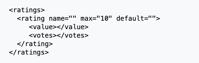

<ratings
<rating default=“false” max=“10” name=“themoviedb”
<value 6.6</value
<votes 2747</votes
</rating
<rating default=“true” max=“10” name=“imdb”
<value 6.9</value
<votes 319863</votes
</rating
</ratings
(this editor blocs >).

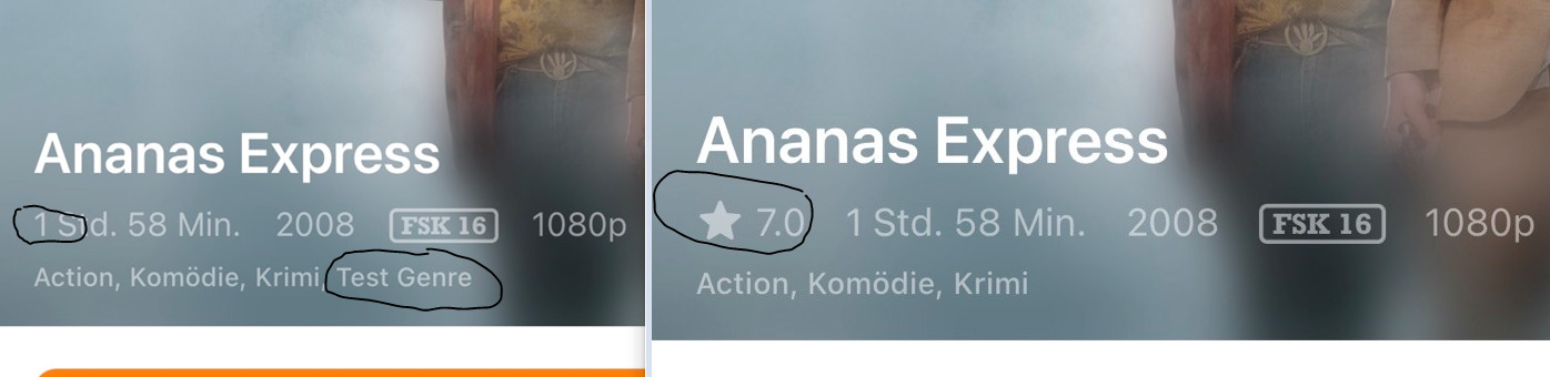

userStarRating is not working. If i switch to online metadata i have a rating, if i switch back to local metadata the rating is missing. i added a test genre in the nfo file to verify that the nfo file is used. but the rating is missing.

Ananas.Express.(2008).1080p.AC3.xml (1.4 KB)
with your Ananas.Express.(2008).1080p.AC3.xml i can see the star rating. But i had to delete my Ananas.Express.(2008).1080p.AC3.nfo file first (with the nfo extension).
I like to use the .nfo (kodi format), because genre, title, etc… is working except the rating. Is it possible to fix this issue?

Take a look at my first post, my nfo file also contains the rating tag. Does it looks ok for infuse?
That is actually the ratings tag which is different. It includes a rating sub item, but this is not what Infuse currently looks for.
Today’s 7.0.5 update features support for additional NFO tags, including: year, premiered, ratings, and userrating
