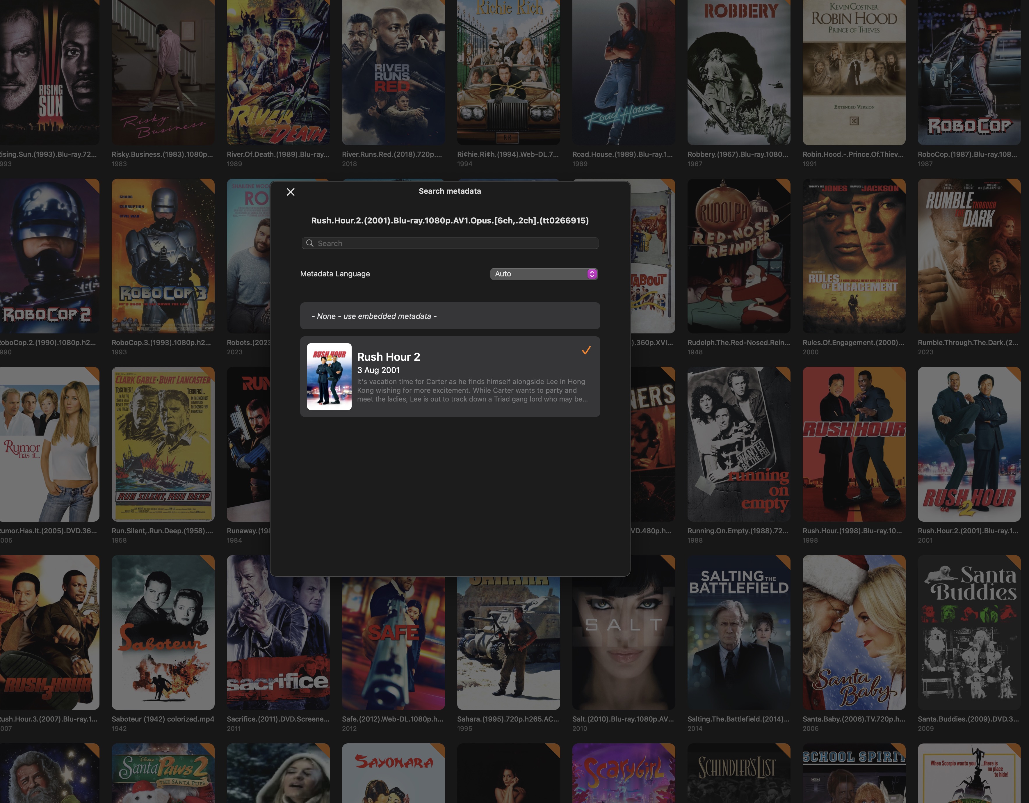

If you go to the movie poster in the favorite instead of the preplayback screen you can long press on the movie poster and you can get the menu with the option to “Edit Metadata”
I get that yes, but then I get the same menu with the same options. I can choose NONE, use embedded (I removed the existing nfo from the folder, otherwise that would be an option too). OR, choose the one infuse brings up, see image.
None of this helps.

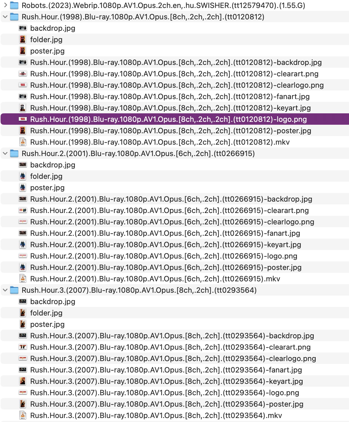

Can you do a screen cap of each of the directors these movies are in?

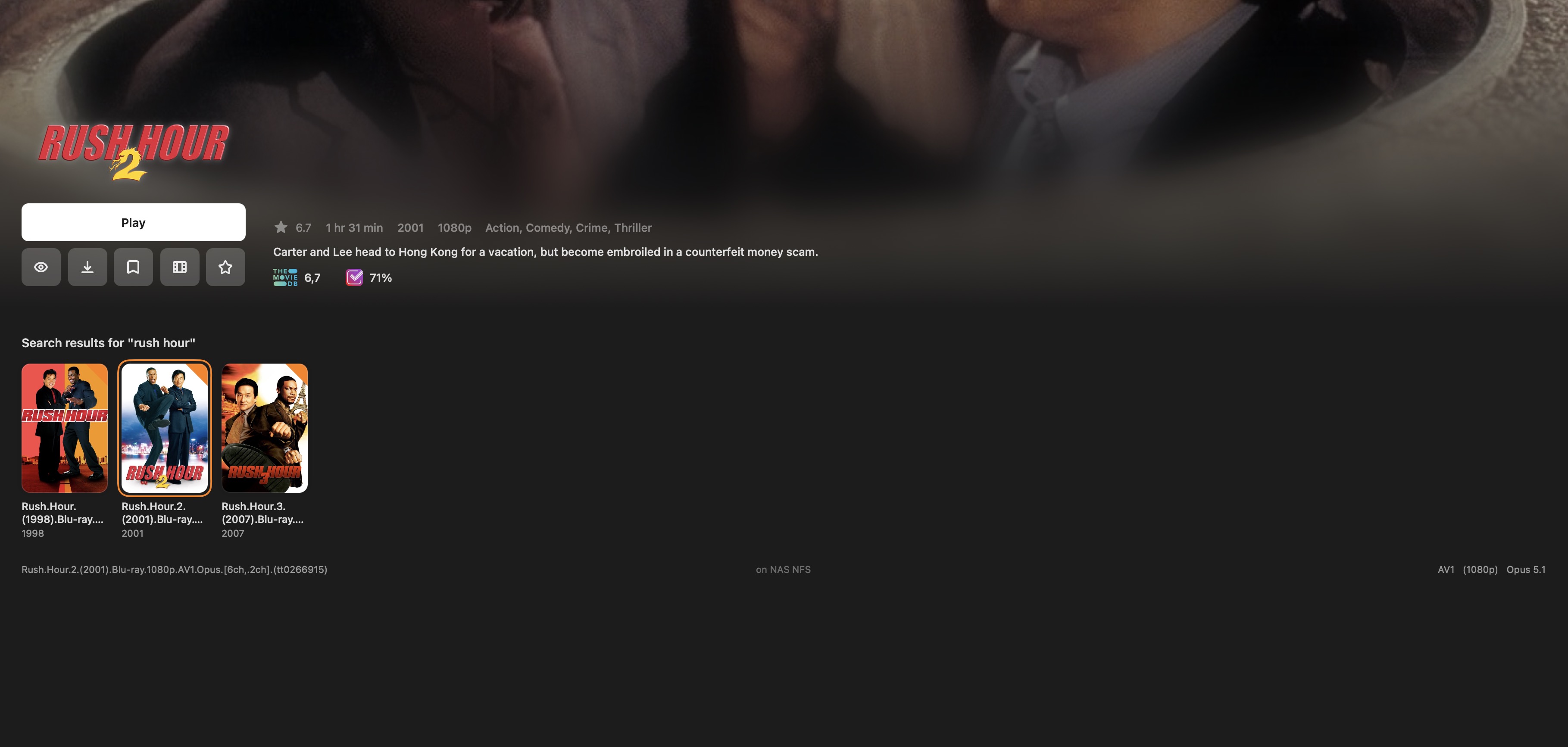

I created this
This is what Infuse returned with no further manipulations
I think it is a bug.
I put all 3 rush hour movies in one folder, and then everything is ok, all actors etc. show up.
So i put them back to their own folder, so a folder per movie. And then for Rush hour 2 and 3, the actor images are gone again.
Weird.
I have seperate folders for all my movies like in the image.
I thought renaming them to just movie name and year would help, but it didnt. Still not showing actors in rush hour 2 and 3.
See image for renamed.
I now also renamed the folder to the movie name also (same). Now it shows all actors for every movie.
But why, it shouldnt matter what the folder is named like, right?
I often find the folder name causes problems if not named exactly as the video file inside. It will also cause series posters to not show if the folder name is off.
One thing to try if your up to it, even though a comma is not listed as an illegal character I’ve had them cause problems. Maybe try one of the movies with the original names for folder and files but without the commas?

One other thing that may be causing problems, the users guide says to use curly brackets for the IMDB numbers so the parentheses may be the issue.
Also not having the “imdb” or “tmdb” may be throwing things off.
You can also include the TMDB or IMDb ID number in the filename (in curly brackets) to allow Infuse to find an exact match. Use a structure of {[source]-[id]}.
Inception {tmdb-27205}.mkv
Inception {imdb-tt1375666}.mkv
