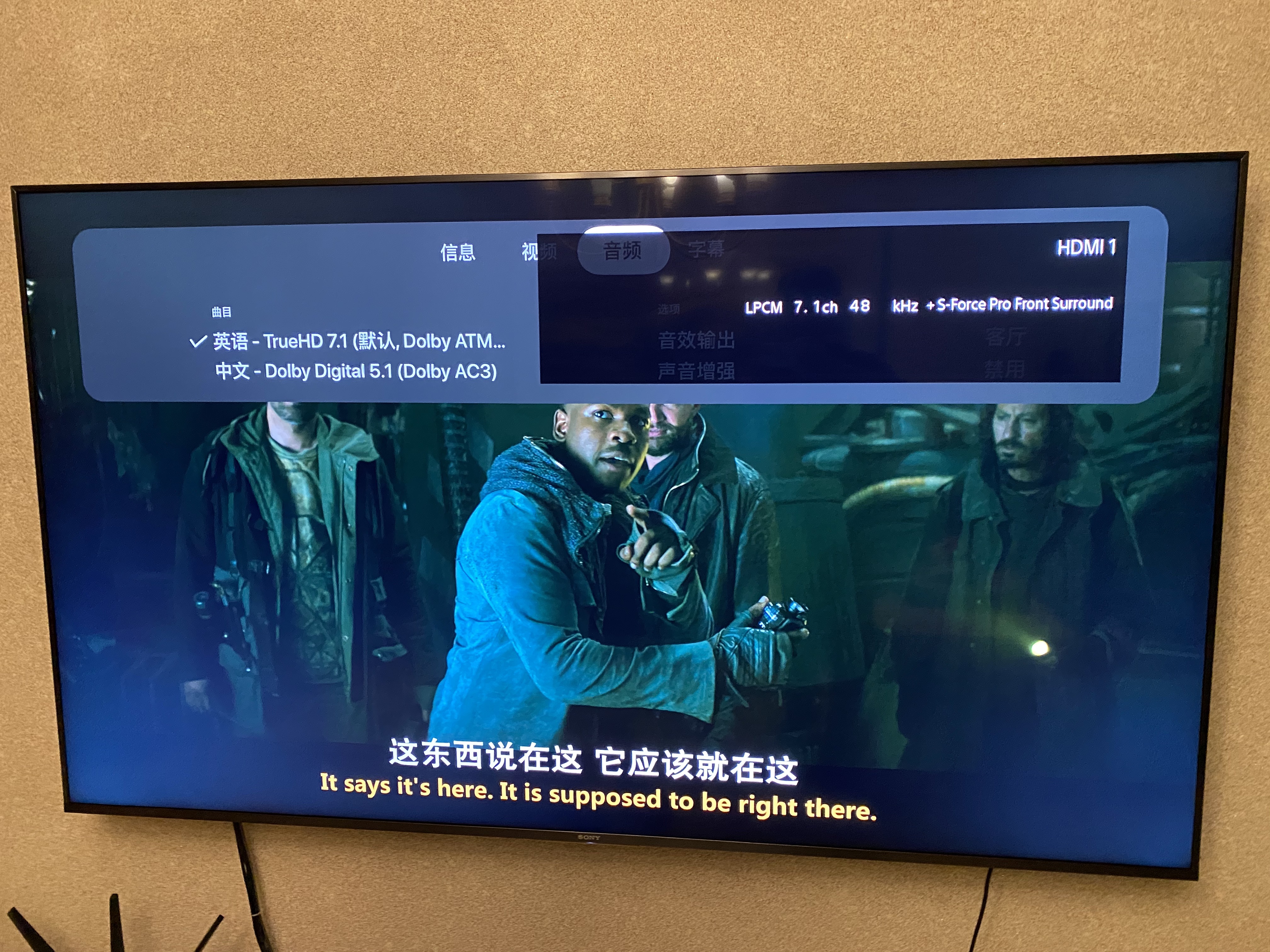

As you can see the attached, the 7.1 audio track was selected but got LCPM 5.1.

Please see the new attached. I even don’t know what I have done to get LCPM 7.1 again.
Weird!
I’m going to say it’s probably some sort of weird HDMI handshake issue. If you only have the 3.1 sound bar configuration I really wouldn’t worry if it’s 5.1 or 7.1 as it all gets down mixed and sent through Sony’s virtual surround processor. If you had a full 7.1 discreet system the it might be an issue.
