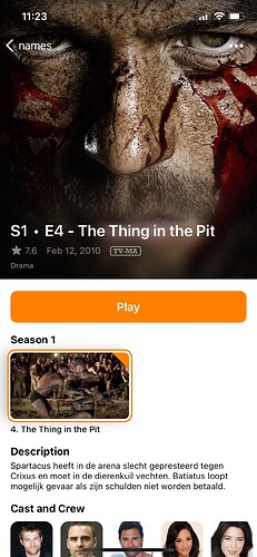

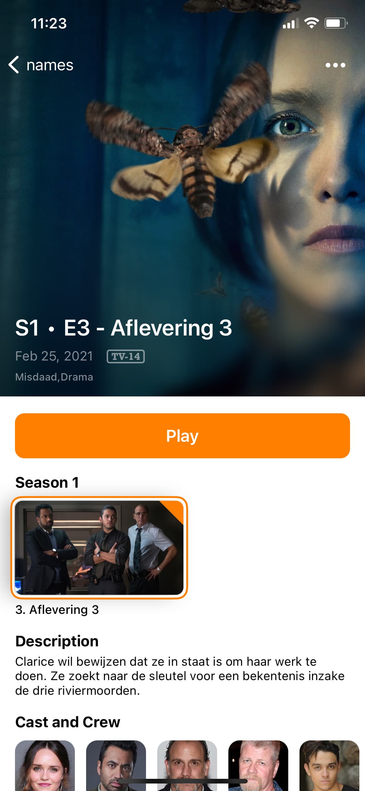

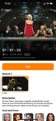

In 7.1 all metadata of Series is in English now instead of Dutch.
Movies are fine though and the info is in Dutch perfectly.
If I do a “edit metadata”, the Serie info is showing in Dutch correctly, but after confirming it, everything is in English.
I checked the series at TMDB and they are all available in the right language.
Already tried to delete all metadata and creating everything new again.
Also changed the option in Settings, Language, Metadata from “Automatic” to “Dutch”
No success. Movies info is OK and all in Dutch, but Series are not.
How can I show the metadata of my Series in Dutch again?

For example:
Clarice (1 season)
Spartacus (3 seasons)
Battlestar Galactica (4 seasons)

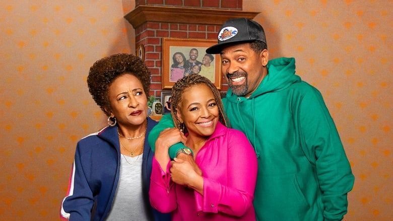

This also includes shows on TMDb with missing english season posters.
Example
Does not have a season 1 English poster so infuse pulls the Hungarian poster. I don’t think that should be the behavior.
This is an interesting one. I think it’s going to be somewhat uncommon for an English series to be missing an English poster, but have a poster in a different language.
We’ll need to think about how best to handle cases like this, as in other cases you may actually want Infuse to grab that poster, even if it’s not in English.
For now, I’ve just added an English version to TMDb so Infuse should pick that up automatically in about a day.
