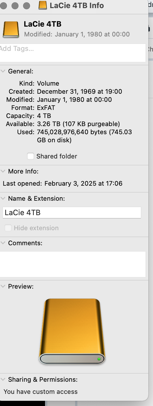

File Sharing is ON ( System Prefs ). BUT when I click Shared Folder on the Get Info window it doesn’t stick !! When I reopen the window it is unchecked ???
Did you unlock the lock at the bottom of the window?
There is no option for that, no unlock button at all see attached??
