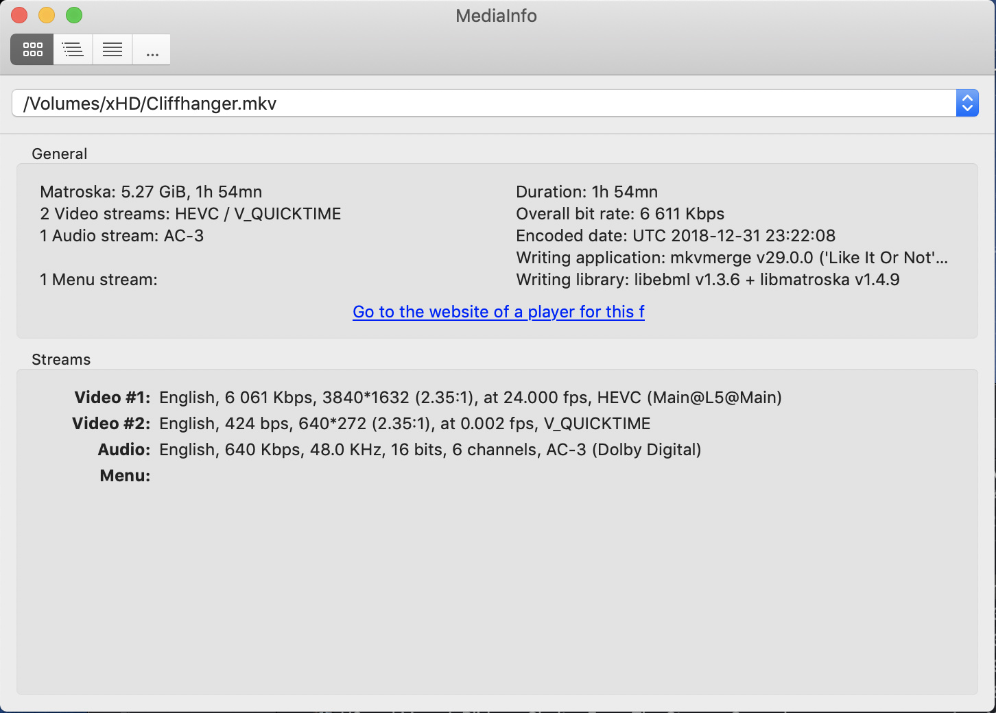

What’s the second video stream? I’m wondering if that’s what’s crashing it?
Just the chapter artwork screenshots, as generated in Subler, upon initial Metadata editing/tagging of the MP4/M4V. I then created the MKV with MKVtoolnix from that file, so it carried the metadata over.
I have these in all of my movies, though, and no problems with anything 1080p and less…

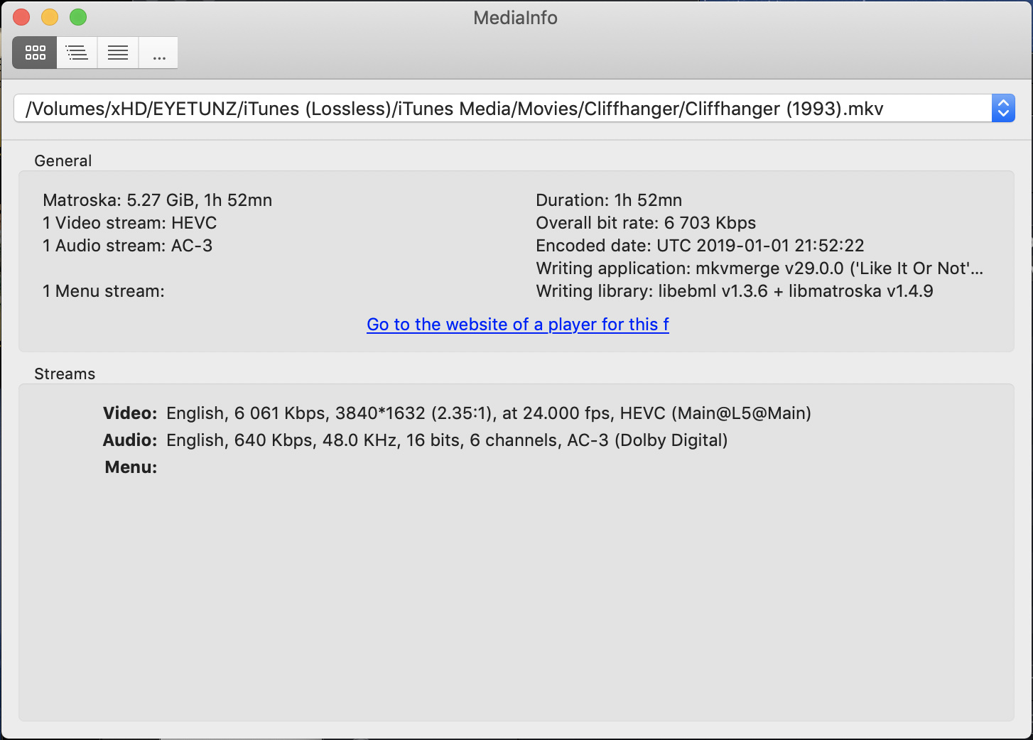

Okay, removing the 2nd “Video Stream” out of the file. Updated MKV - updated MediaInfo Export file and screenshot attached.
Same result: crashes in iOS and now I’m getting only audio and no video whatsoever - not even green screen, just blackness.
p.s. I still get green screen / flickering green screen on the MP4/M4V file, though…
cliffhanger_1993_4k.txt (5.8 KB)
