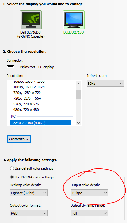

It looks like that particular monitor is only 8-Bit+FRC, so you won’t be able to experience full 10-Bit HDR video.
In this case, I’d recommend forcing the Apple TV to output SDR, and you should be able to get the correct colors.
There’s a thread with some discussion on 8-Bit+FRC vs 10-Bit here.

From proper playback of HDR content from an AppleTV the panel has to be a 10bit panel, UHD colour has to be enabled on the port, colour depth/black level should be set to low.
