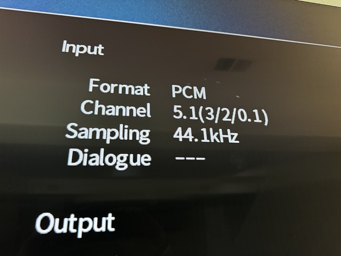

Dear Infuse Community,
with my recently purchased ATV 4K Gen 3 I made - rather accidentally - the strange observation that both with Infuse but also with (almost) all other video/streaming apps (e.g. Youtube, Netlflix etc.) the stereo or multichannel audio track also re/downsamples to 44.1 KHz when de/transcoding to LPCM.
This behavior only does not occur if
  • a Dolby Atmos (transported in EAC-3/DD-Plus) audio track is played (correct playback of the 48 KHz sampling rate, both when playing back via Infuse but also, for example, when playing back a corresponding title with Dolby Atmos sound on Netflix),
  • playing back songs on Apple Music (even the correct sample rate switching works here, i.e. songs with 16 or 24 bit | 44.1 KHz are played back with 44.1 KHz; songs that are also available in High-Res Lossless are played back with 24 bit | 48 KHz; albums and songs that are available in 3D Audio/Dolby Atmos are played back with 48 KHz accordingly,
  • (the same) videos are played back with MrMC (Plex), in this case the audio track is played back in the original sample rate of 48 KHz.
Unfortunately, I can no longer determine whether this behavior is related to the update to tvOS 17.0, since I bought the ATV 4K 3rd Gen only shortly before the release of tvOS 17.0 and have already installed the latest tvOS version very soon after its release.
However, I also still own an old ATV 4K 1st Gen, with which I tried something around today and wanted to check whether the behavior described above can be reproduced during audio playback. Both with tvOS 16.5 still installed on it and after the update to tvOS 17.0, all audio tracks were played back in 48 KHz, regardless of whether LPCM or Dolby Atmos incoming. Even the songs played via Apple Music are always played back at 48 KHz - the old familiar behavior, because as far as I know the audio output of the ATV has always been limited or fixed to 48 KHz, regardless of the incoming sampling rate.
I would now be interested if anyone has made similar observations and can reproduce the described behavior with the latest generation (3rd Gen) of the ATV 4K from 2022? Of course, I would also be happy if this problem/behavior could be fixed in the future. However, I have the impression that it is due to tvOS and therefore probably cannot be solved by Infuse/Firecore alone.

I did some testing here, and was able to replicate this on the 2022 ATV4K. On the 2021 ATV4K the audio is sent as 48kHz, as it always has been.
This is affecting other apps such as Netflix and Apple’s own TV app when 5.1 (non-Atmos) audio is sent. The same thing also happens when AirPlaying 5.1 (non-Atmos) content from the TV app to the Apple TV.

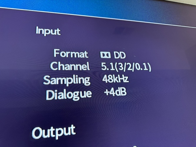

When playing E-AC3 Atmos audio in Infuse (and Apple TV) the correct 48kHz audio is sent.
Forcing the Apple TV to send Dolby Digital (change Audio Format setting in Settings > Video and Audio) also sends 48kHz.
We’ll need to dig into this to see if there is anything we can do from the Infuse side, but the fact the TV app and AirPlay are also showing the same behavior seem to indicate this may be a system level bug that would need to be fixed by Apple.
