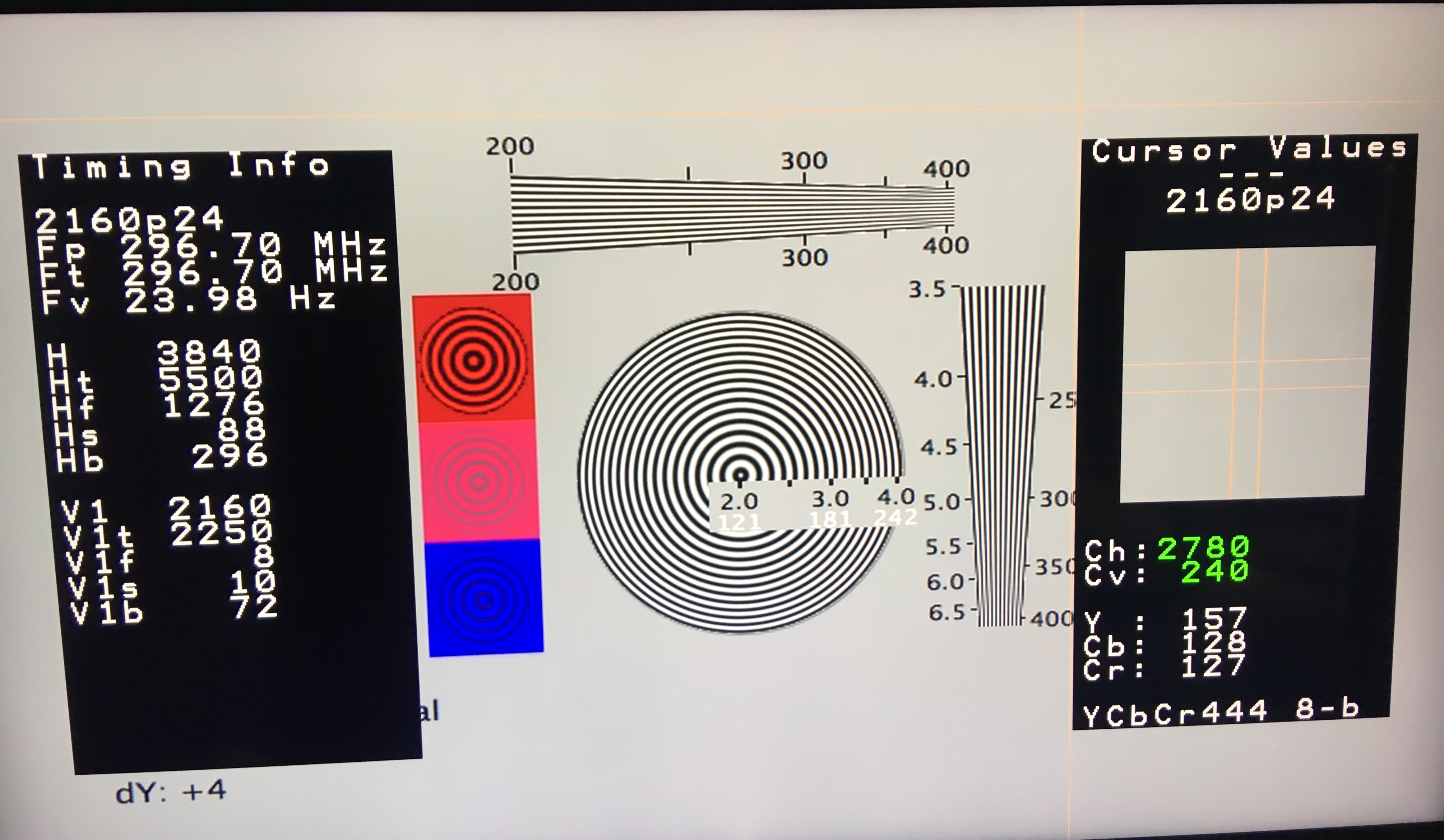

I purchased an Apple TV 4K yesterday so I have been able to do some actual experiments, but primarily on HD-DVD sources, and only a few DVD sources.
What I found is this:
To get 24p output from my DVD sources (so far) I must set the Format to 4K SDR 24Hz or 1080p SDR 24Hz (use SDR since HDR didn’t exist for DVDs), AND SET Match Frame Rate OFF. It seems counter-intuitive to set Match Frame Rate OFF, but it’s because of the way 24p film sources are MPEG2 encoded on DVDs. In many (most?) cases they are encoded similar to the method used for HD-DVDs, and those settings would then produce judder-free 24p output. I discussed that here:
However, unlike HD-DVDs, the encoding rules for DVDs allowed several additional encoding methods (I’ll skip the technical details). I haven’t been able to test how the ATV4K will handle those other methods yet. And the flags on DVD’s were notorious for being wrong too often, which would break judder-free 24p output. I’d guess the ATV4K is likely a flag-reader only, and if so should have problems with many DVDs. To get optimum 24p from DVDs normally requires cadence-detecting algorithms, or a combination of cadence-detecting and flag-reading.
I’ve attached a picture captured from a DVD film-source (3-2) moving zone plate test pattern that shows the 23.98p timing and frame rate. The moving zone plate was output without any 3-2 pulldown judder.
