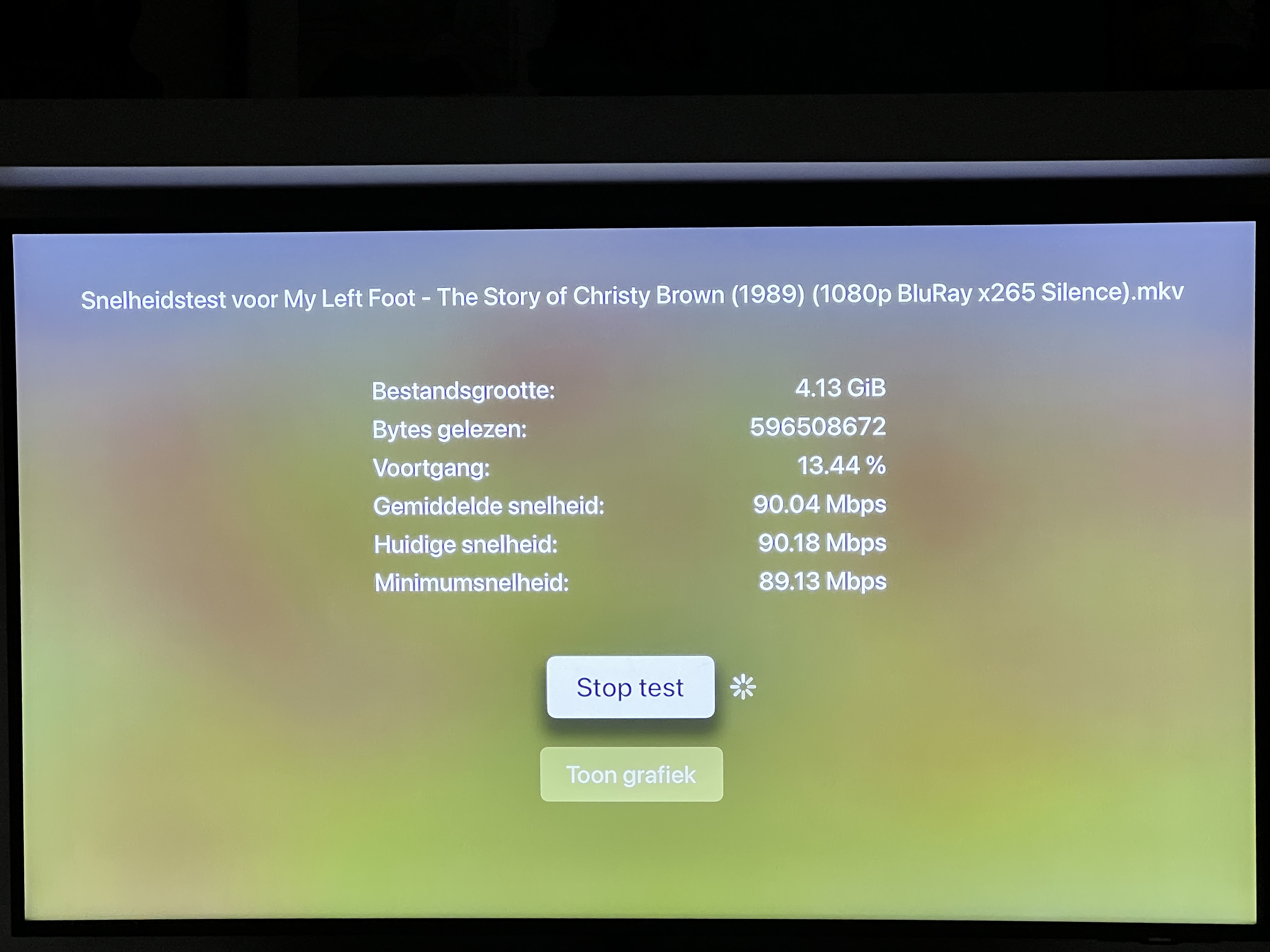

Hi everyone,
I’ve switch to a new NAS system, Synology DS923+ and I’m having trouble playing 10 bit MKV files. The color turns grey and it skips.
I have the latest AppleTV 4K A2843, Synology DS923+ latest firmware and use SMB (I’ve also tried NFS without luck…).
Does anyone know what settings I could check?
Thanks in advance!
Jeff

Check the cable. How many veins? 4 or 8 ? Perhaps the patch cord is badly compressed. Do you have the ability to measure the speed of the cable itself? Judging by the speed test above, your cable outputs 100 megabits.

Btw the screenshot above is from the AppleTV, not from my iMac.

I just found out a speedtest on my AppleTV 4k 2022 wired is about 100mbps, but wireless it’s suddenly times 5…
Now i’ve found a few posts of people saying they are experiencing the same thing but no solution yet.
I’ve set-up my AppleTV wireless now but the 10bit movies are still grey and stuttering…
Also the AppleTV in de living room (AppleTV4k 2nd) is doing fine with the cable speedtest around 500.
And the 10bit movies show the same problem so this doesn’t seem to be the solution unfortunately.

Sounds like you either have an old Ethernet cat5 or earlier cable or cat5 or earlier switch/router stuck somewhere in the loop. Another possibility is a weak newer cat cable. I had a cat 5E cable that would max out at about 30Mbps. Guess where it was when I found it… (Hint connected to a device with the initials ATV :wink: ) Changed it and all was well.
The WiFi speed isn’t surprising, the newer levels are fast as long as you don’t get caught with the interference gremlins. One misplaced metal item near a device can cause havoc.
